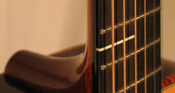

PostPosted: Thu Jun 29, 2006 2:38 am
Serge, I use the plastic rods which are very easy.
here's one I just did:
